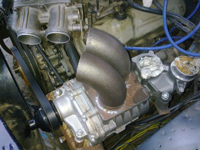

Na isikelsiu foto parodysiu, flansa padariai ir vedziok kur nori :wink:
iLuvJDM
Posts: 115
Joined: 18 Aug 2008, 15:00
Re: supercharged e34 535i
Post by iLuvJDM »
Na va, darbu eiga :wink:
Eaton'as
