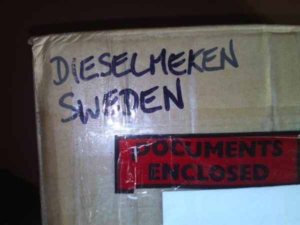

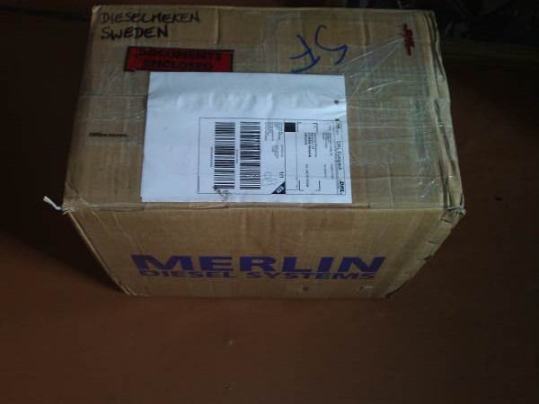

Stai ir jis...

Dariusmientas
Posts: 110
Joined: 27 Nov 2008, 20:02
Re: Project: Mercedes 190 su OM606
Post by Dariusmientas »
jei nepaslaptis kiek atsejo siurblys su siuntimu?
Swecias
Posts: 184
Joined: 16 Apr 2011, 16:57
Post by Swecias »
Dariusmientas wrote:jei nepaslaptis kiek atsejo siurblys su siuntimu?
1kE
