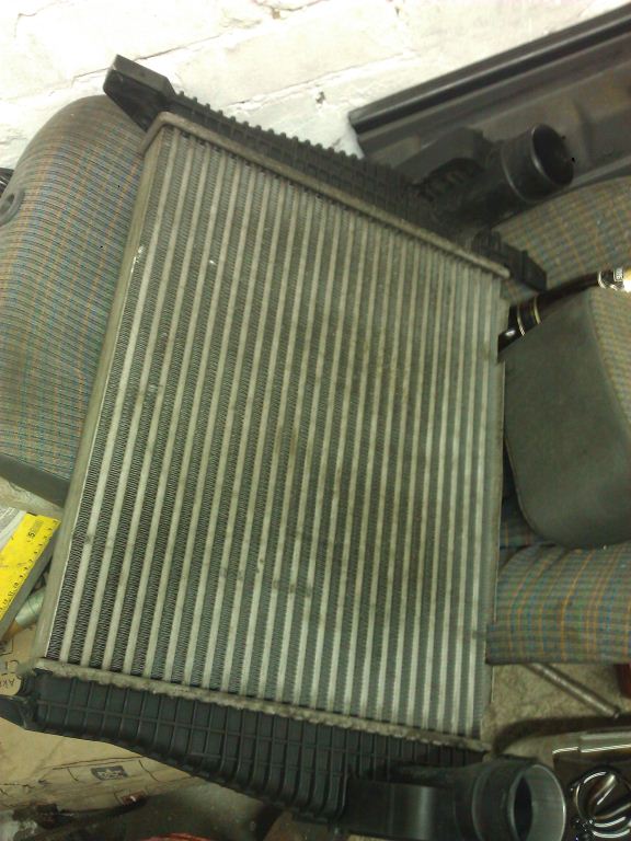

Beje parduodamas ismetimo kolektorius, gal net turbokompresorius hx40w
- mmm.jpg (89.59 KiB) Viewed 11518 times
- WP_001515.jpg (65.57 KiB) Viewed 11518 times
- WP_001511.jpg (95.17 KiB) Viewed 11518 times
Re: Project: Mercedes 190 su OM606
Nuo ko interkuleris ir kiek kainavo?
saab.. 30-90lt.
Nebijai kad i/c galus nupus?
- romkasponka
- Posts: 3479
- Joined: 11 Jan 2006, 10:15
- Location: Vilnius
- Contact:
variantas, nes jei pusi kokius 3 barus/3kg i kvadratini centimetra. 6x30=180kvadratiniu centimetru, o tai jau 540kg
